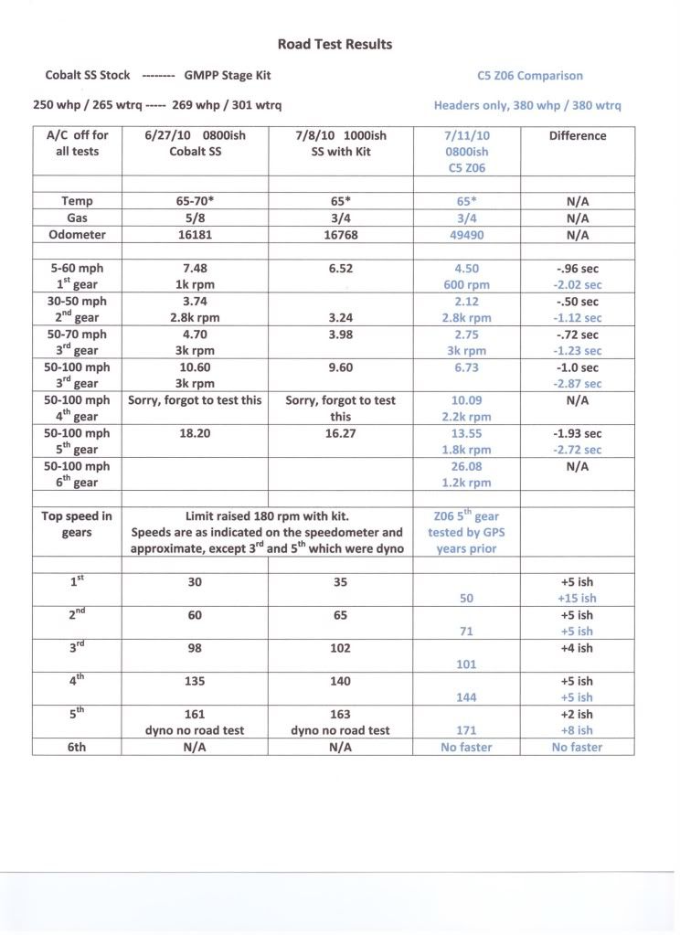

I just completed my GMPP stage kit on my 08 SS turbo. Here are my before and after comparisons, both dyno and road tests.
Keep in mind all dynos read a little different so your results may vary. Road Tests were done on the same roads with another person in the car using a stop watch, so they aren't exactly perfectly scientific in their execution but they are fairly accurate. I did two runs of each test and averaged the two runs.
Cobalt GMPP Stage Kit road test results
6/27/10 0800ish and 7/8/10 1000ish --- Difference
Temp 65-70* / 65*
Gas 5/8 / ĺ --- + 1/8th
Odometer 16181 / 16768 --- + 587 miles
A/C off for all tests
5-60 mph 7.48 (start in 1st gear 1k rpm) / 6.52 --- -.96 sec
30-50 mph 3.74 (start in 2nd gear 2.8k rpm) / 3.24 --- -.50 sec
50-70 mph 4.70 (start in 3rd gear 3k rpm) / 3.98 --- -.72 sec
50-100 mph 18.20 (5th gear roll on) / 16.27 --- -1.93 sec
50-100 mph 10.60 (start in 3rd gear 3k rpm) / 9.60 --- -1.0 sec
Top speed in gears
(just under 200 rpm limit raised with kit)
Except for 3rd and 5th gear, Speeds are as indicated on the speedometer and approximate since I didnít want to run on the rev limit too long
1st 30 mph / 35 mph --- +5 ish
2nd 60 mph / 65 mph --- +5 ish
3rd 98 mph (actual speed on dyno) / 102 mph --- +4 mph
4th 135 mph / 140 mph --- +5 ish
5th 161 mph (actual dyno no road test) / 163 mph --- +2 mph

Updated results with comparison
Since I had numbers for the Cobalt, I thought I should compare them with my C5 Z06. I went out this morning and completed the same tests on the same roads with my Z06. As you can guess the Z06 is significantly faster in a straight line. How much faster? Here ya go:
The time comparisons are the difference between the kitted Cobalt SS and my nearly stock C5 Z06.

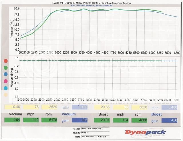

Here are some comparision results. I used the same type of dyno. My car had an *unknown tune..(not GM1) when I got it and the results here show that tune vs an HPT tune over that one for some modest gains. You'll not that the BOOST is LESS than your car and a tad LOWER with the HPT tune vs the *unknown* tune on my car.. Yet HP/Torque #s are greater.
Green Line is *original* unknown tune. Blue Line is HPT Tune.
Boost
As far as performance #s, I got these with a stop watch:
My car 3rd Gear 50-75 MPH 3.8 sec. Note that you have 3.98 Sec, but that's 50-70..5 mi per hr less in range. I figure 1 sec additional for the 5 mph, so you're at about 4.98
My car 3Rd Gear 60-100 MPH 6.4 sec. Note that you have 50-100 9.6 sec, but that's another 10MPH MORE in range..that's *worth* about 2 sec, so I figure your car is about 7.6 60-100MPH.
In general, my car is about 1 sec quicker...whicn makes sence given th HP/Torque differences.
