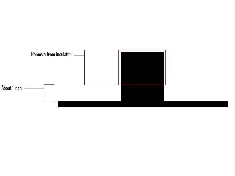

Step 4. The upper insulator is a 2 part insulator. One is a hard plastic disk with the upper bump stop integrated into it. The other is a soft neoprene like disk that fits between the top of the spring and the hard plastic insulator. Measure from the flat portion of the hard plastic insulator down the bump stop about 1 inch, mark it and cut it. Feel free to remove a little less material from the hard plastic but when you are done the edge of the plastic should be about even with the upper metal bump stop that is a part of the car.
LINK: http://i84.photobucket.com/albums/k30/Montecarloman/Upperbumpstop.jpg
