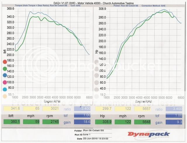

Here are some comparision results. I used the same type of dyno. My car had an *unknown tune..(not GM1) when I got it and the results here show that tune vs an HPT tune over that one for some modest gains. You'll not that the BOOST is LESS than your car and a tad LOWER with the HPT tune vs the *unknown* tune on my car.. Yet HP/Torque #s are greater.
Green Line is *original* unknown tune. Blue Line is HPT Tune.

My car 3rd Gear 50-75 MPH 3.8 sec. Note that you have 3.98 Sec, but that's 50-70..5 mi per hr less in range. I figure 1 sec additional for the 5 mph, so you're at about 4.98
My car 3Rd Gear 60-100 MPH 6.4 sec. Note that you have 50-100 9.6 sec, but that's another 10MPH MORE in range..that's *worth* about 2 sec, so I figure your car is about 7.6 60-100MPH.
In general, my car is about 1 sec quicker...whicn makes sence given th HP/Torque differences.
