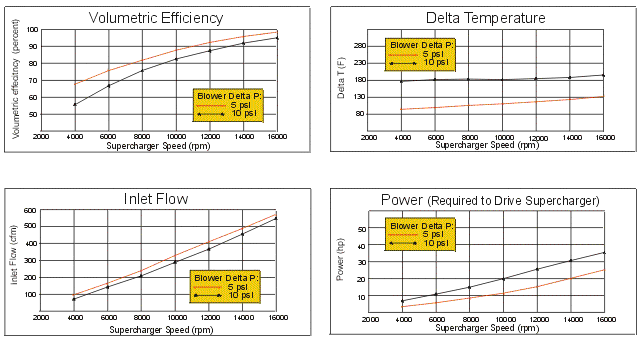

As far as the supercharger's top end, that's adjustable with the pulley. Leaving the stock 3.35" pulley on, and bumping the limiter up to 7500 wouldn't overspin the blower at all. Also, the new Eatons in the Redline and SS/SC are good to 16,000 continuous RPMS, not 14,000 peak RPMS, as alot of people assume.
454 Posts
Here's the genV Eaton data:
