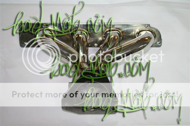

Got a prob? I bought a Pacestter header for my 2008 2.2l g5 the tubes are longer than my other one so it needs fabrication. I took it to a shop and the dude said if he cut the pipe to make it fit then i would have the check engine light on constantly i guess because the o2 sensor on the stock downpipe or whatever it is?? How can i gets this mother 'frrr installed right???
5 Posts
Please do explain???? cause I looked at it and the stock header is like half the the length of the pacestter, its a short stubby SOB and the it looks like the downpipe would need to be cut.
Premium Member
362 Posts
Fabrication means different meanings to each person.
It will BOLT directly to the cylinder head. However the "fab" part is sawing (cut) your stock exhaust system, just before the OEM cat converter. The downpipe connects to the stock exhaust at this point.

check out the OVER THE TOP PERFORMANCE LONGTUBE header
its a little expencive but best performance and best sounding
www.o t t p erformance.com
Do we have multiple dyno pulls to backup the 'best performance' statement? Do we have any clips for the sound? I'm sure some don't want drone while others want raspy others want deep tones ect... I'm sure a custom tune is required for this one too.
Also I think we would all agree in general a long tube header has netted bigger gains for V8 Trucks and muscle cars, I hope that holds true for our little 2.0...
31 Posts
ok your right its personal preference but for a modified 2.0l with like a 2.7 or lower pulley tvs the equal leanth and long tube design should give it more hp as far as dyno and sound clips look on you tube or their website for that info
most other ones cylider 4 and 1 are alwas longer then 2 and 3 creating less balance
